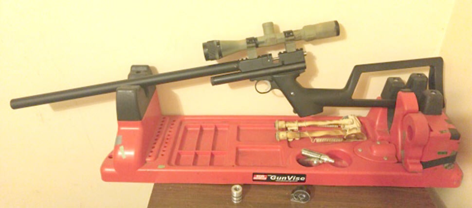

An update on the gun. I'm not excited with the chrony numbers but one step at a time!
doesn't shoot bad at 50 yards considering I chopped the barrel and "crowned" it  ;D and the awful extreme spread/deviation.
Here it is so far. Next up is hpa tank, reg, and adapter. I don't know when JDS Will restock but it'll be awhile i assume.
arkmaker †
Looking real good!
Now for the tuning. I'm not sure what you ended up with for a PA, but you may need to be able to back it off less than stock for a flat string. If you made a PA from a stock cap, that is not possible. I am using the stock Disco cap on my Disco that is drill and taped to 3/8-24 and I can back off enough to get a pretty flat string in the 800 fps range. The Disco cap is much longer than a 22xx cap. I found that if it is un-regulated, then I had to settle for less power which gave me more shots and a flater string. I can crank inthe PA anytime I want to boost me back into the 900+ range if I need to take out a tree rat.
Did you get a chrony yet? It will help fine tune it to your liking.

And for the tuning. I have magnum air power adjuster. As well as some minor porting and made a poly tube transfer port. Maybe I'm expecting too much from a 17" barrel and gauge-less 19" disco tube? I settled with this tune for now but should and will tune for lower extreme spread, better efficiency. I plan on a 24" barrel soon.
20 shots
Start fill 2000 psi JSB 15.89gr
729
739
734
742
737
755
758
767
772
777
781
784
792
797
794
791
779
772
748
Min 729
Max 797
Avg 766
ES 68
SD 22
End fill about 800-900 psi
I did notice my first 5 shots were on quite the extreme angle down perhaps causing the 25+ fps jump on shot number 6 and that's the only 25+ fps jump in the string not including shot 19 to 20. So tomorrow I will do a more thorough chrony session and power adjustment tuning. But the consistency has potential I think.
It groups well for my own barrel chop and haven't had a formal target session. As I have no rangefinder yet, I haven't the need for heavy target work. I do have a 50 hard range and will get some paperwork done soon. I mainly hunt but certainly love shooting paper.
Next steps are a 24" barrel, perhaps a LW from mac1 is what I'm thinking. I know, sheesh, this gun is getting up there in price and my girlfriend sees it as a money dump plus I still plan a drop tank adapter, tank and reg! But this is what I want and since I can't afford to drop $1000+ on a high end gun at once, I'll make my own over the course of several months  ;D
Speaking of drop tank adapters, I don't know when JDS will restock so I'm wondering has anyone here made one their own, to go nicely with a 22 ci tank?
Thanks everyone for reading!

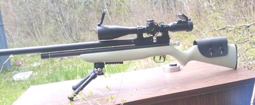

Working on one now with that drop block. I say I'm thruogh building and next thing I know I'm working on another one!  :D :D :D
M3ga3t
I just had to  ;D the spending on this gun won't end  ??? Will get a better pic up or too when I can
arkmaker †
Ohhh! Nice stock! Which model is that??
